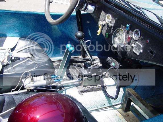

I like this idea. Set it where you want it then fine tune it as you go. A single cutting brake will work with a spool but IMHO this keeps it simple and keeps you from having to search for levers as you're bouncing through the desert.
Just set it up to lock both, like a hydro e brake, will have to set up for a corner but will still lock them and get the back around
I only say this because playing with the brake biased while racing in my opinion is cumbersom, get the brakes setup where the truck stops the best without locking up the fronts, then have a hydro e-brake. I've had situations where I needed all the brakes I had and i didn't have time to turn something back or move a lever, only takes one time turning the front off and not turning them back and something happens and you need more brake.
Put your handle on your side, like between your hips and knees, put it at a height that is easy to come down from the steering wheel and land on it, you will never miss it. I have thousands of miles behind the wheel of a desert car, I've never once missed my brake lever.
