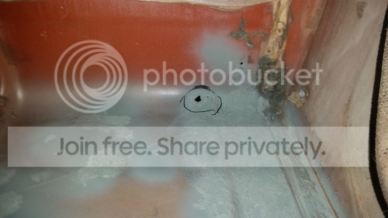

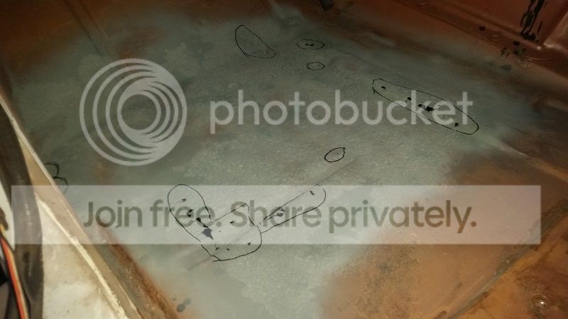

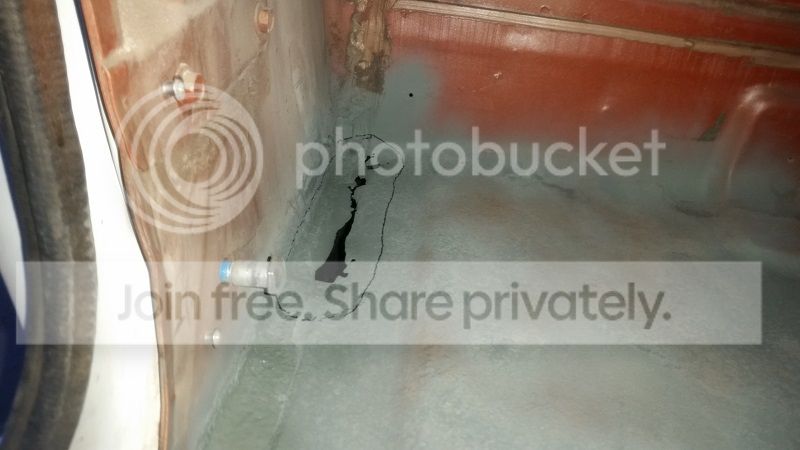

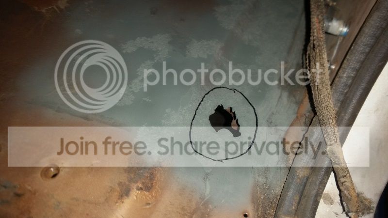

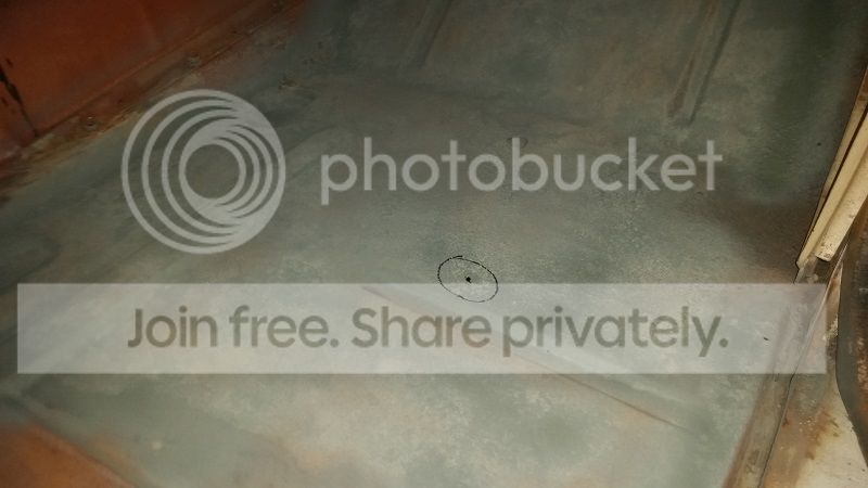

Got in there tonight to get a better idea of how much rust is actually in there.. It's not as good as I was hoping. Couple of pretty good holes. Should be able to patch them.

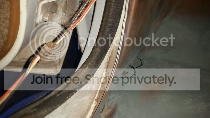

There is one spot where I'm not sure how to get in there. The driver side kick panel - where it meets the floorboard. Really tight spot in the corner - actually goes underneath the kick panel. Any ideas on how to cut that out?

Torch?
I'll ruminate on that for a bit. Not sure how much I trust my torch skills, but that may be that I have to do. Barely got the grinder's wire wheel in there to find those holes.
I am hoping that the torch suggestion is just BS!!
That much heat would probably warp crap and IF there was any sealer around, it would get cooked out next to the cut.
Of course a plasma cutter would keep the heat low as to reduce damage.
A body saw may be a good option, depending on the reach with the blade when you get into the corner.
Maybe a carbide bit in a drill? I have done that for some things to slow the cutting down. Maybe it would be ok for sheet metal. Dunno. ..
Hmm, don't have a plasma.... I keep thinking I'd buy it and not need to use it again...
I did however just buy several carbide burrs that are pretty decent. May try that.
That's what I meant by body saw. I have used mine a fair amount, but I can't tell you how well it will reach into the corner.
But I have found other ways to use it too.
:rolleyes: Bigger torch
If you have a die grinder, a carbide tip on an extended shaft might reach in there
