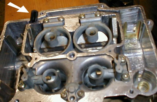

For what it's worth I have personally ridden in a buggy with a 366 that ran excellent with a 1406 carb.
Basically his trick was an electric fuel pump plumbed in parallel with his mechanical one, then the set the float very low and had a cheap parts store regulator that gave the carb just enough fuel to run properly during normal driving. Then when lots of power is needed the electric pump can be turned on to cram the extra fuel needed past the regulator.
Sounds funky but it works and very well, wouldn't have believed until i saw it done and rode with him at Disney, OK.
Wow this is just what I was looking for! Thanks! I have an electric fuel pump hooked up now and I still have my mechanical fuel pump. Do you by chance know what psi he set his regulator to? Or how low he set the float?
Wait hold up a second, wasn't the reason my truck was dying on inclines because of the fact that I was getting too much fuel and it was choking out? Not sure how this setup would help me, besides the fuel regulator part which I have been considering...
I have heard the old timers used to turn the pressure down to 1 psi with a remote regulator on the floor, the electric pump idea could work but I'd be worried about it keeping up in the sand or something should you come up on it. Fuel pressure is easy to change.
Tuning a carb like that really is just a general idea you have to dial in.
I have run 1 psi before and lowered floats.
You pretty much do as low as possible while still allowing the rig to run.
Another thing you can do is to add some foam in the rear crossover to aid in slosh from one side to the other.
http://www.ih8mud.com/tech/carter.php
Lowered float did the most for me aside from the mods I mentioned above. That was using a mech pump. Would have preferred an electric in retrospect
