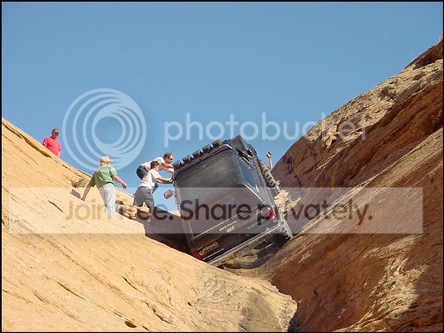

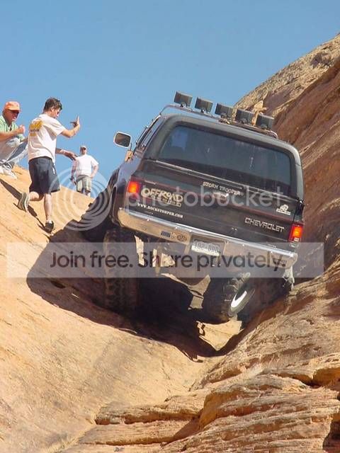

Couple of my favorite Blazer Bash pics are of a guy that runs an Edelbrock 1406:
I have heard the old timers used to turn the pressure down to 1 psi with a remote regulator on the floor, the electric pump idea could work but I'd be worried about it keeping up in the sand or something should you come up on it. Fuel pressure is easy to change.
That's why he runs the electric pump as well. There's a toggle switch on the shifter that when you get to sand or a hill climb where lots of power is needed you flip it on and it overrides the regulator to get more than the 1 psi used normally. It was a just an elcheapo inline regulator from the parts store.
