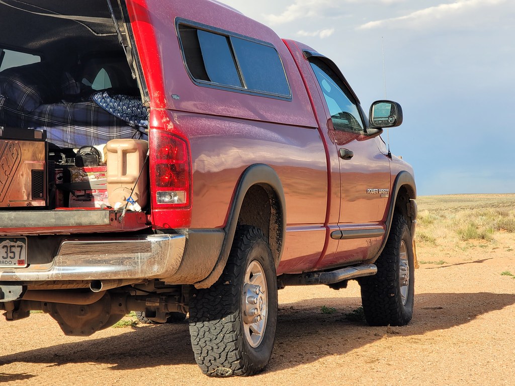

So one of the things that’s been lacking on our runs is an easy way to get water for washing hands, dishes or other needs. Trying to dump water out of a 5 gallon can is annoying.
So I pulled an idea from the web to put a hand pump on an extra cap for the scepter water can.
The pump is from Fanspray and it’s pricey but built well.
Simple install. I picked up a new cap for the can. Remove the larger of the two caps to allow for the pump install. The instructions said to cut the threaded portion off and then cut a new hole with a 1 3/8” hole saw. I strayed from the instructions when I realized the hole saw ID was tight to the threaded portion. I just chucked it up and drilled it.
Then after attaching the pump to the lid you just add some food grade silicone tubing to the end of the pump to allow it to reach the bottom of the can.
I won’t leave this pump in as I travel as the cans collect a lot of dirt back there.

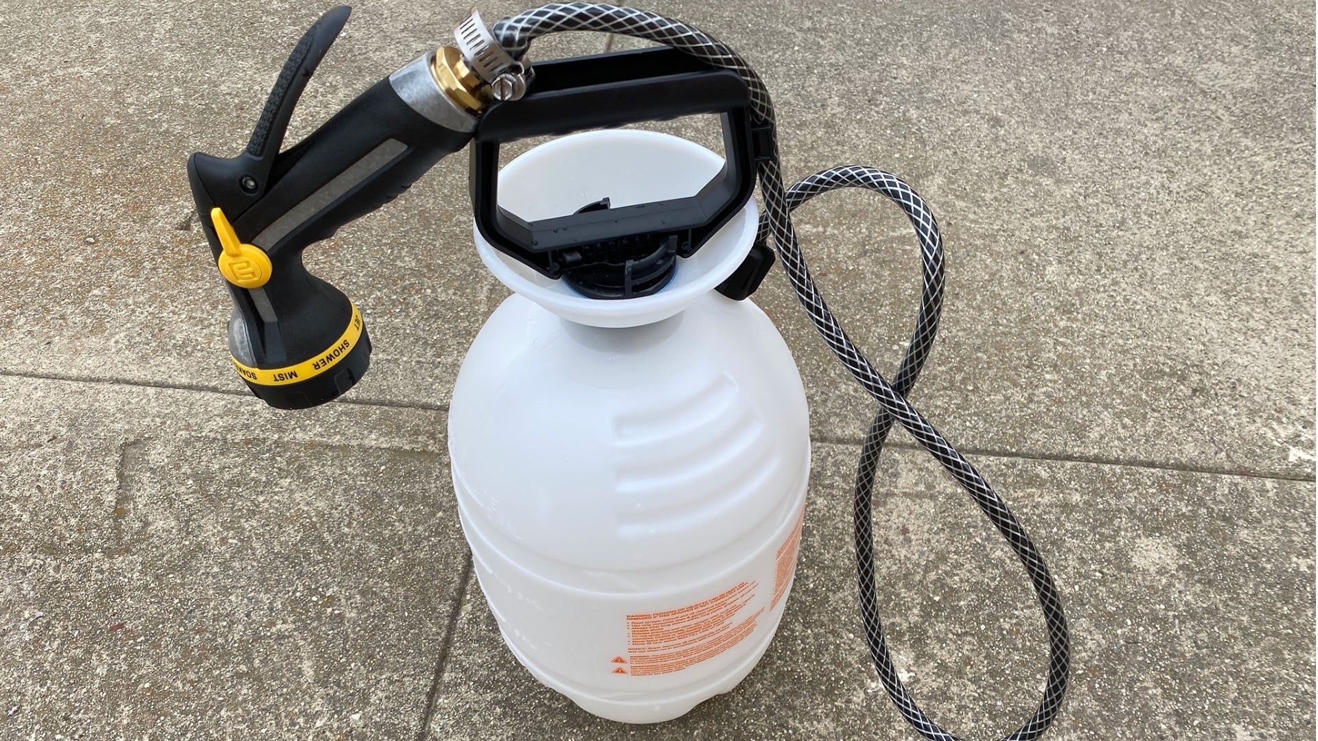

I have a submersible electric pump I use for washing & showering. When it fails, I'm planning to switch to a sprayer setup like this:
Cheap. Simple. No batteries required. And you don't need to take the can out of the rack to use it. :thumb:
