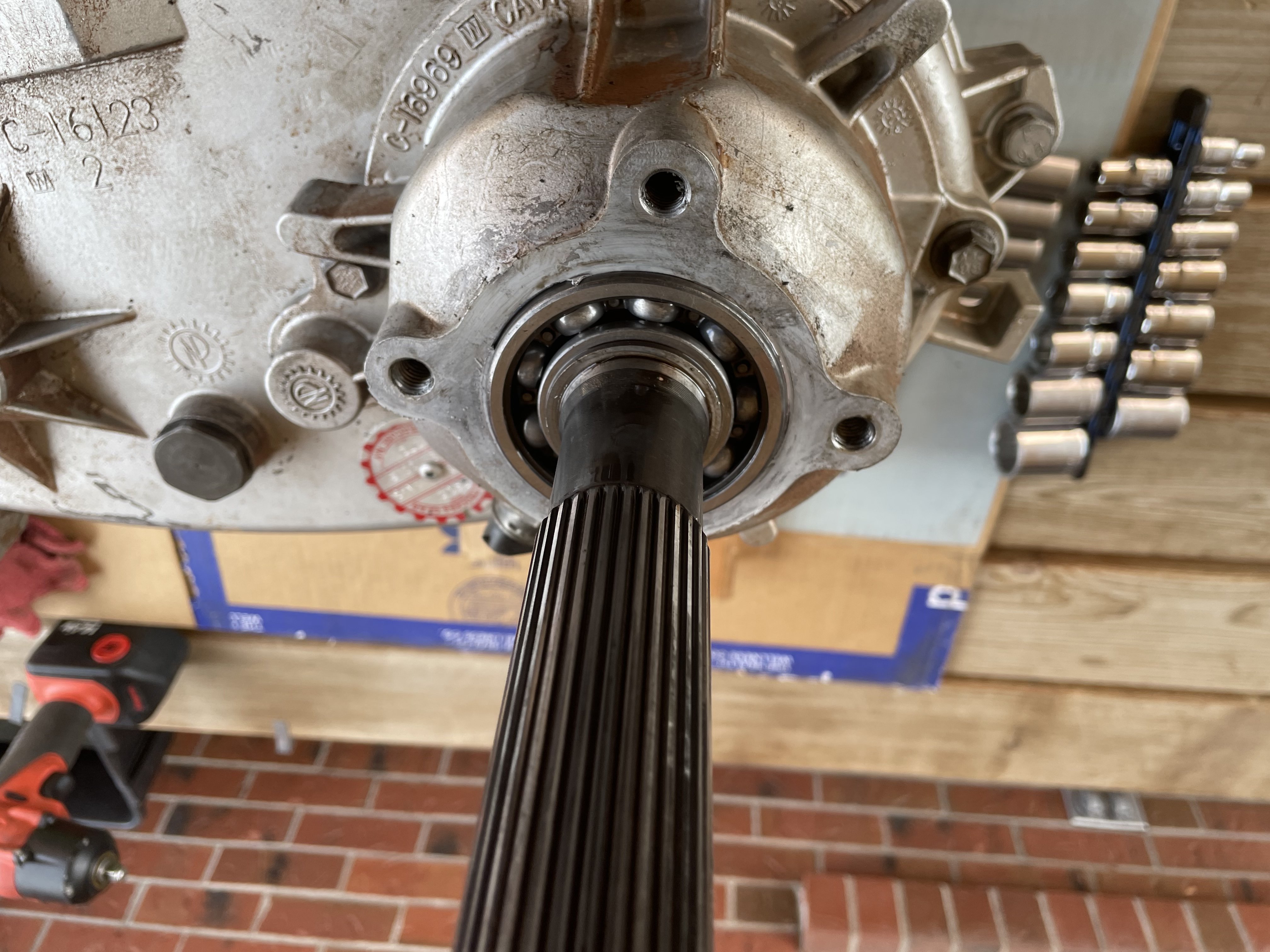

I figured if I took it apart a couple of weeks ago I might need help putting it back together. View attachment 431083

Never been apart since it came off a driving truck.
