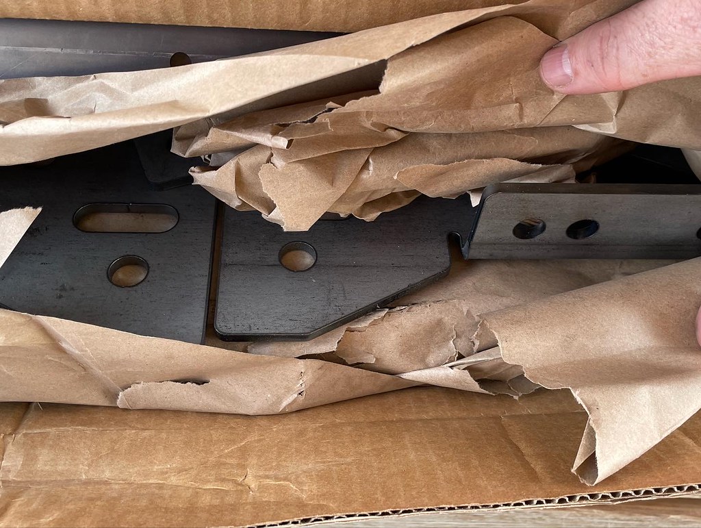

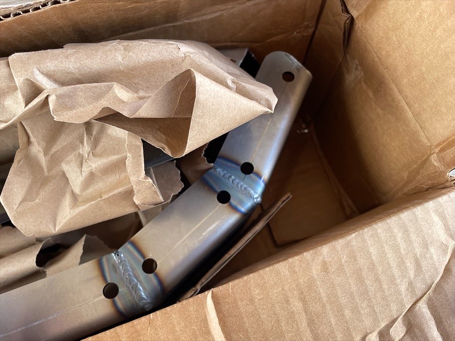

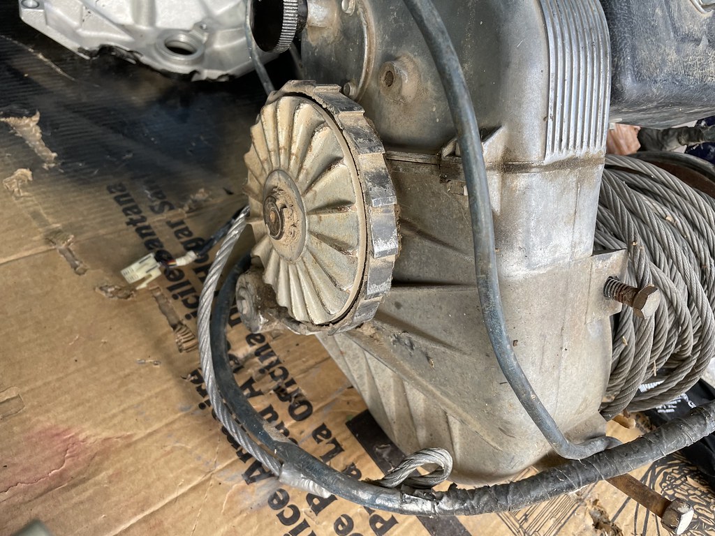

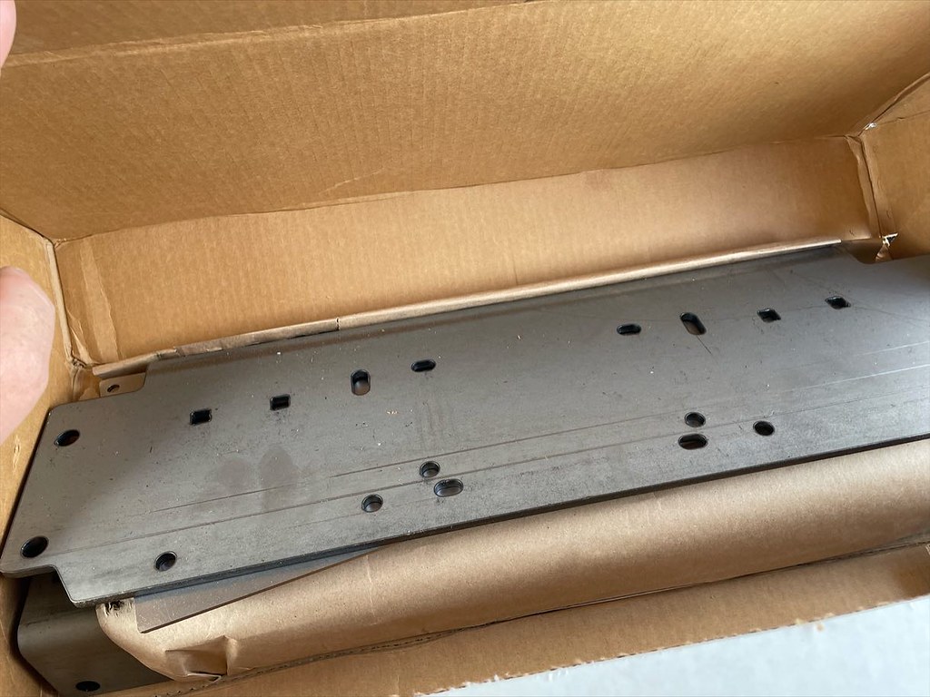

Not a whole lot of movement. I got the correct pass side drop rear bearing housing from @fourxpete and other than some cleanup it's going right into the mix. Thanks dude. I didn't do anything last weekend as I ran to Pueblo to say hi to my buds down there in front of the holiday. I did rescue my new-to-me winch though. 1977 vintage Warn 8274. It fits in with my plan to drop into the @Engineered Vintage front bumper sitting on my doorstep this afternoon when I got home. I want that built vintage accessory-type vibe to go along with the camper. KC's may get tossed into the mix too.
I spent my downtime between calls this week researching updating the 8274. I have a laundry list of part numbers at work. The basics will emulate the current 8274-70 model currently offered by Warn with a 10,000-pound rating. The really cool fact is that the updated rating doesn't come from anything mechanical within the winch at all. It's all electronic. A 6.5 hp motor and a solid-state albright contactor relay are the main changes. I've got the numbers for the service kits for the brake/clutch and the lower housing seals/thrust washers to rebuild it right. I think the teardown/reassembly should be pretty fun to do. All in at my price for the parts, the winch itself and synthetic rope I'm still going to be at a third of what the retail price is for the new model.

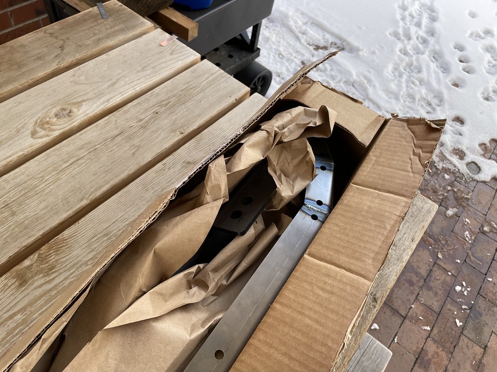

I moved some stuff around and snuck a peek in the boxes. Wow...
Really nice stuff for sure.
The quality of the cuts are amazing.

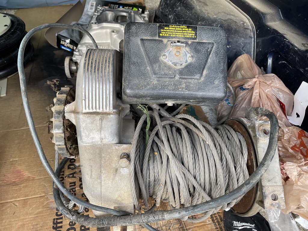

The winch is crusty, but has good bones. My personal favorite is the quality clips on the main power and ground cables.
In a lot of the research I've done, it's pretty common to have the free-spool handle freeze up and stick in or out. To my surprise the handle pulled out to the free spool position on the second try and I could even feel the detent.

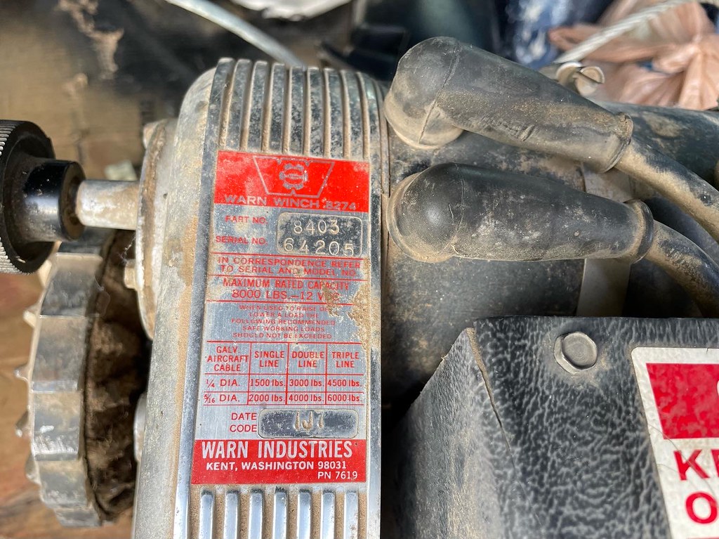

By the date code, it's an old one. IJ7, which if I decoded it right, came out on July 14th 1977. The relay cover and metal 4-pin control plug also point to 1977 vs 1987.
