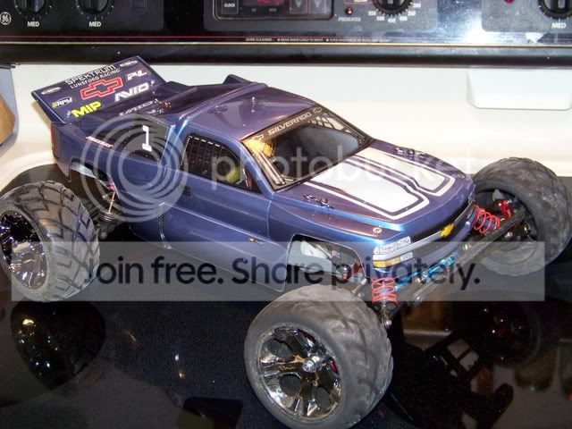

Here's a pic of my Rusty. Lots of STRC aluminum bits, widened front track to match the rears (all RPM arms), STRC aluminum shocks with variable orifice pistons, Aluminum Gearbox and Slash 4x4 driveshafts. I was running MIP shafts for a long time with a ton of abuse, but finally ended up shattering one of the bells. It's a blast to drive in a wide open space.
