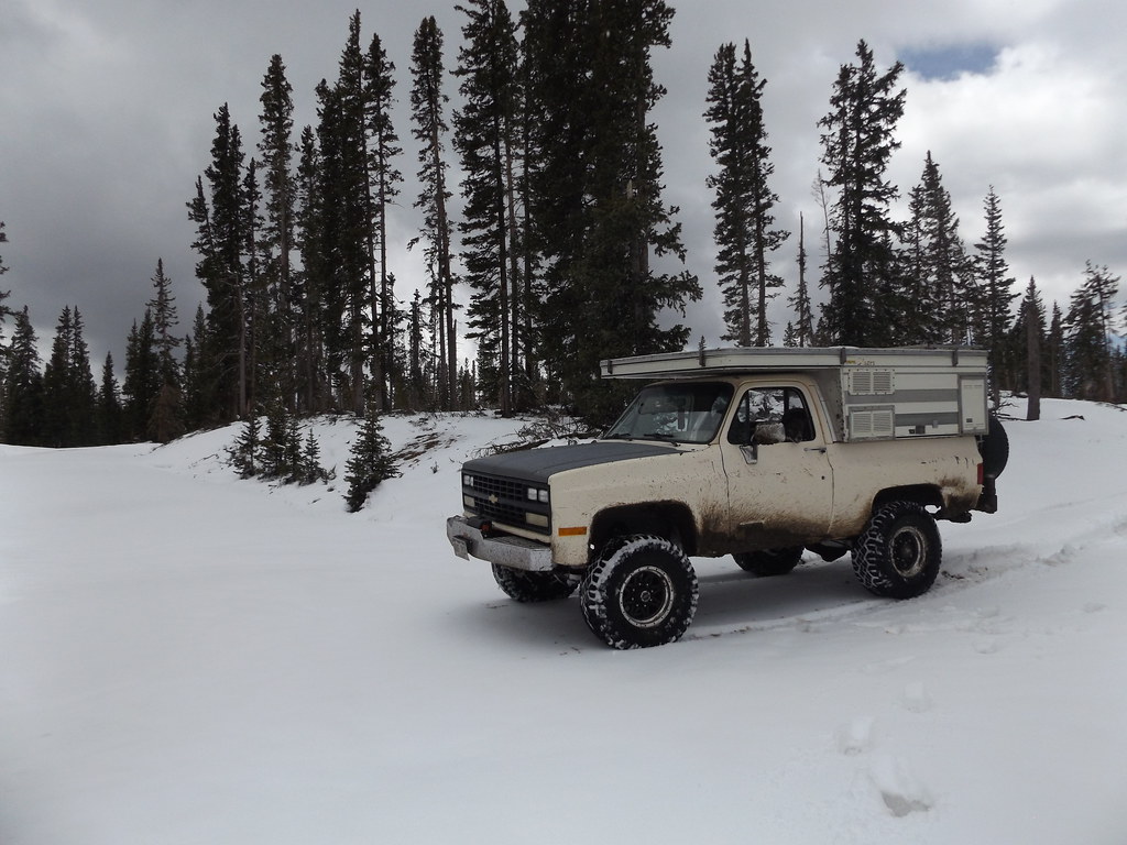

We ran our pre-desert trip validation run today. The original plan was to do an overnighter. With the recent weather in the high country and other changes in others plans the overnight idea got scrapped. We decided to do a day run up to our normal new years day snow run stomping grounds. It would give a good mix of highway, dirt/washboard and with the weather mud and snow too.
The group was our buddy Bill in his Taco, John in the TJ and Ian with is almost finished CUCV Blazer running the standard Larry issue 8.1/nv4500 and me with my K5. Ian's ride has been a work in process for 3 years at least now. Today was the first major shakedown. He's ridden shotgun with me the last two years but is now ready to pilot his own ride. It's pretty close but still needing some wiring gremlins eliminated as he's got one headlight working and only the voltgauge on the cluster working. But the drivetrain was on point today. Outrunning me up a large hill in 5th gear on the interstate on the way down proved that.

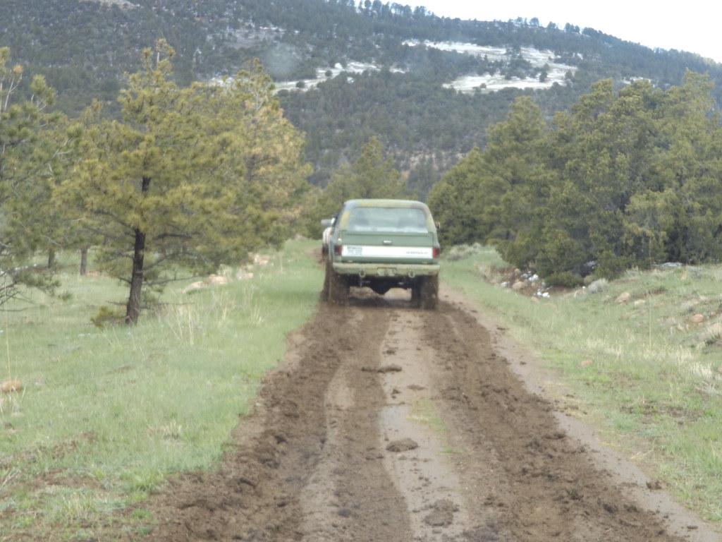

Once the gravel turned to dirt we realized we were in for a mess today. The road was wet and gooey as brownie batter. Ian and I both are running Wrangler Duratracs and we both found they balled up heavy. We never seemed to stop moving, but we did slide around a bit.
It was into this muck Ian felt the brake pedal get soft on him. He quickly found one of the hardlines on the rear axle got tweaked when he was adjusting the backlash the other day. Tightening the line didn't change anything so we pressed on with him using his trans to help slow down, but the front brakes were unaffected.

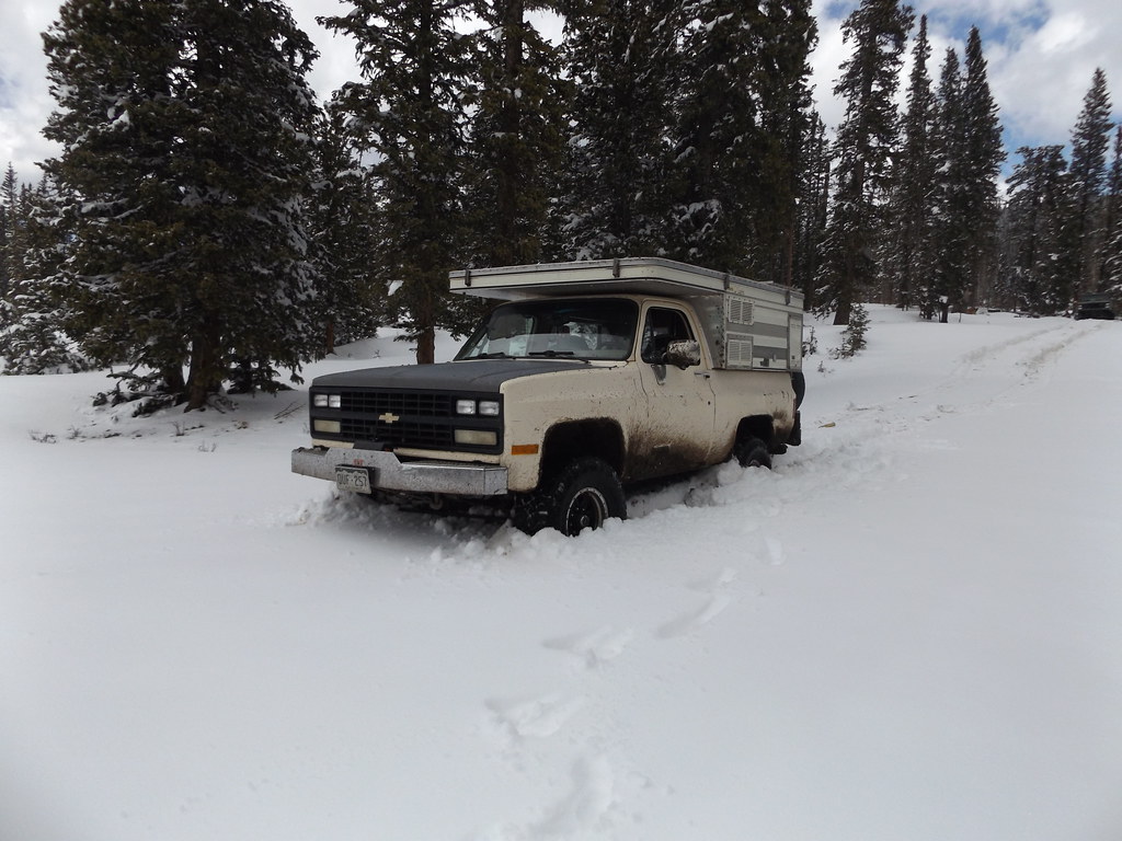

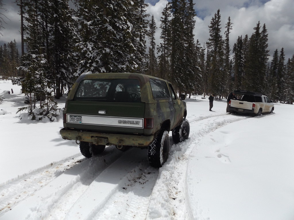

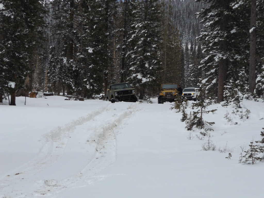

We got into snow above 9500 ft of elevation. Some spots were still pretty deep on the edges. Everybody but John in the Jeep got stuck enough to require help to get out. But we gained another 1000 ft up and found some deep snow everywhere. Bill was leading the way and went right at a fork and made it 50 ft and buried it to the rockers. We got him unstuck and he took another try to only get stuck again. Ian lined up for the extraction.
Did I mention it was muddy? John's yellow jeep was turning brown fast on this run.

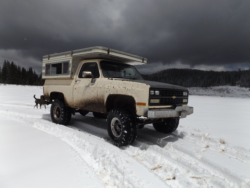

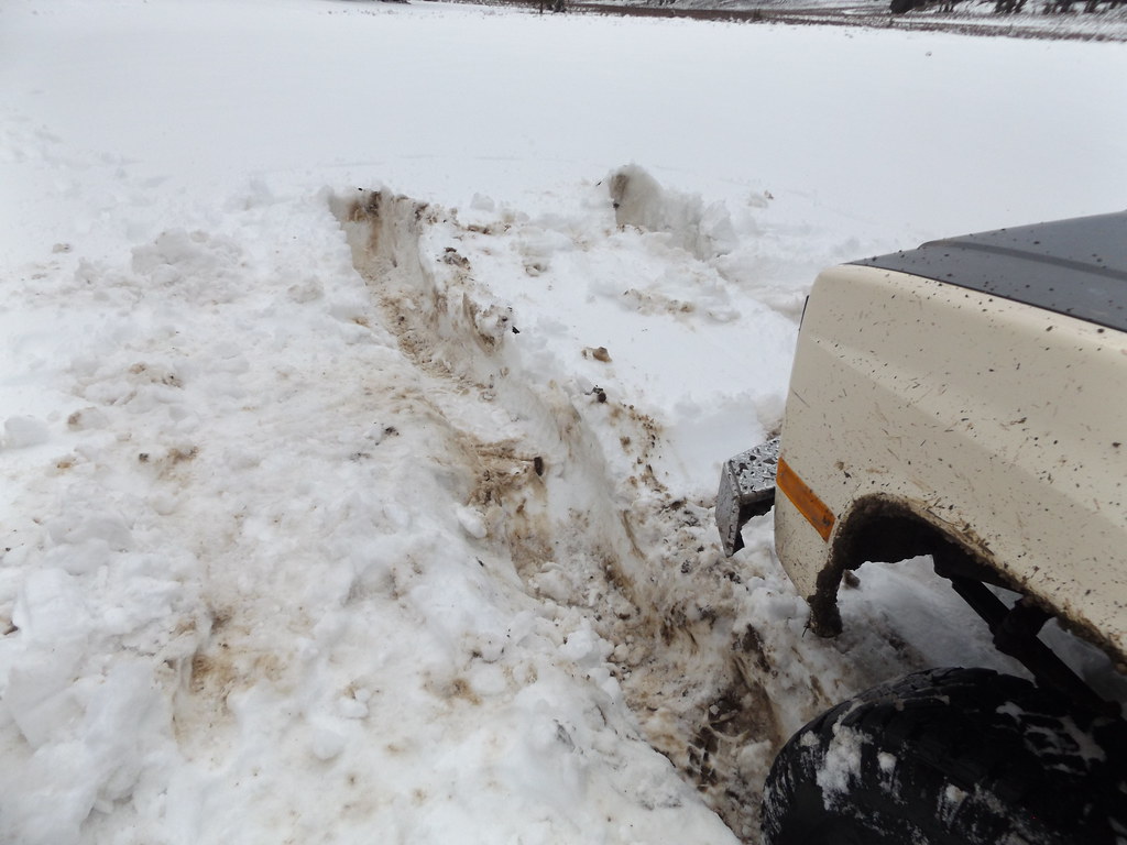

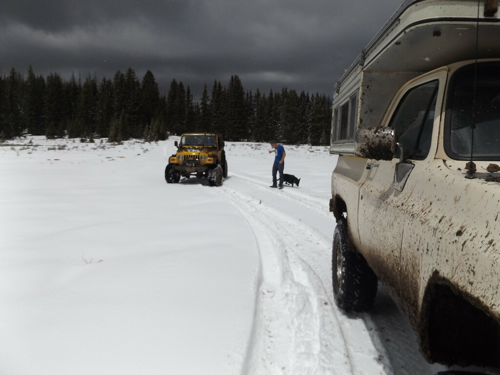

I got out ahead to break trail and got a good 1/2 mile in where I hit a wall of hard packed snow. High centered the whole rig on the frame. It was a solid 2 1/2 feet deep there and packed hard enough I could stand on it without breaking through. We tried to get Ian up to help me since he had more mass/hp to yank me out but he managed to get stuck too. Bill rescued him.

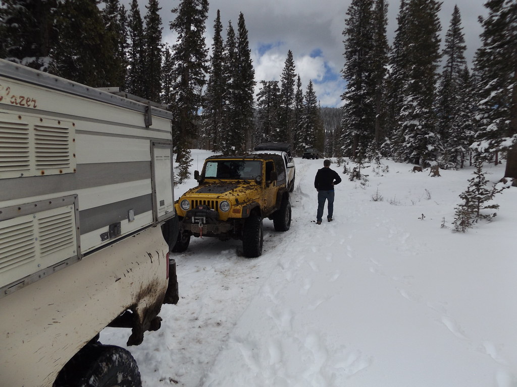

John was able to get to me and tried the snatch strap and it wouldn't budge my stuck ride from the snow. So we broke out his winch and even with his brakes locked up, just pulled his jeep to me. We needed more weight. Bill made his way up and we strapped the Taco to the Jeep. Some slow action with the winch finally popped me out.
It's deeper than it looks.
We wisely backtracked and made our way down the mountain and headed home before it got dark. It was a good run. Ian found a couple issues that could have been bigger on the road. He's got a week off before the trip to get the kinks worked out. Mine did fine, but I have to bolt the bench down. The rough road had it moving around back there. Plus the lid needs some kind of latch to lock it down and keep it from rattling. Otherwise it's in need of a good cleaning and it's ready to go.

Mud is the big problem with spring trail running.
It was fun but I hate the clean up. Spent $15 at the car wash and still didn't get it all. What I did get splashed back on me from head to toe. So I had to take a shower when I got back. I've got some chunks to still knock off in spots.

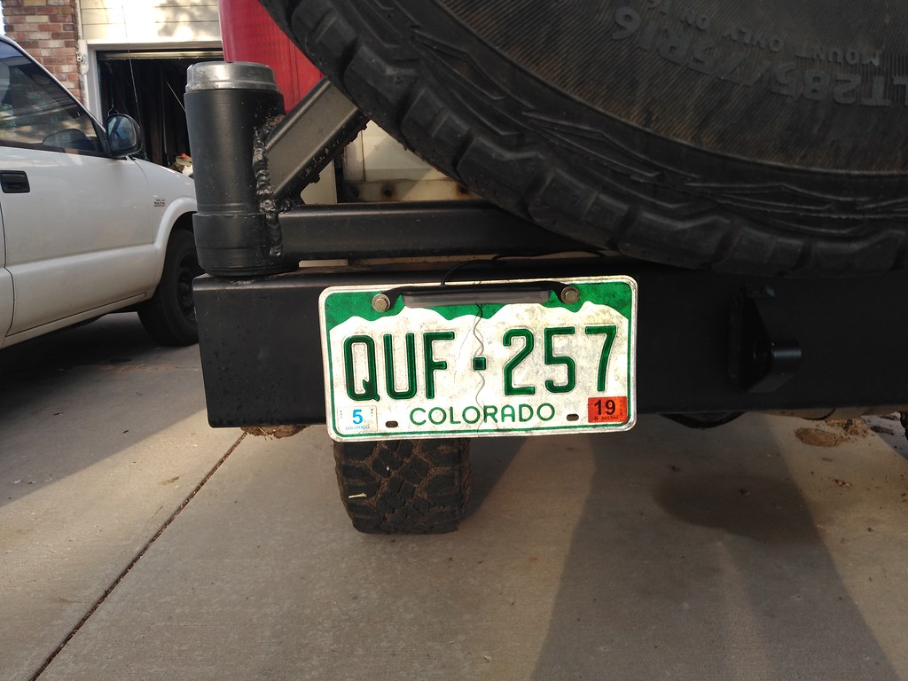

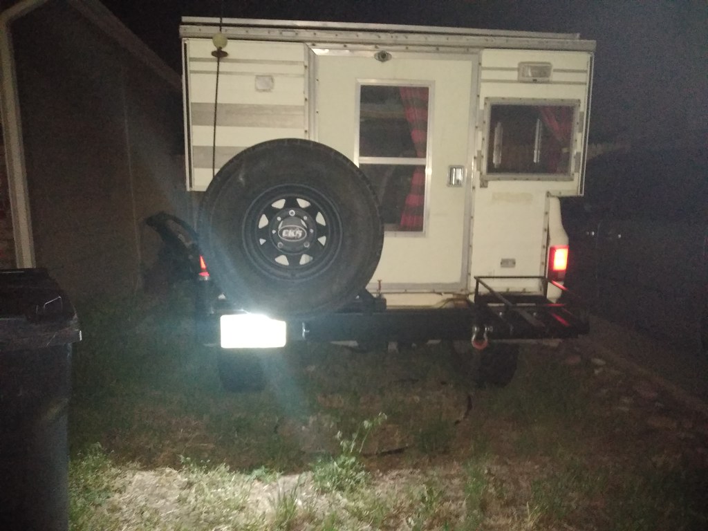

Bill and I got some stuff done yesterday to get ready for the Desert trip. One thing need was getting the plate mounted. I picked up a bright ass LED light for it off of Amazon too. Drilled and tapped the holes for 1/4" fasteners and repurposed the wire off of the stock plate light to wire it in.
Yes, I have to renew my tags this month too.
But the light is bright as hell in the dark. I need to add some LED's for the backup lights to keep up. That's not the flash reflecting off of the plate, it's the brightness washing out the image.

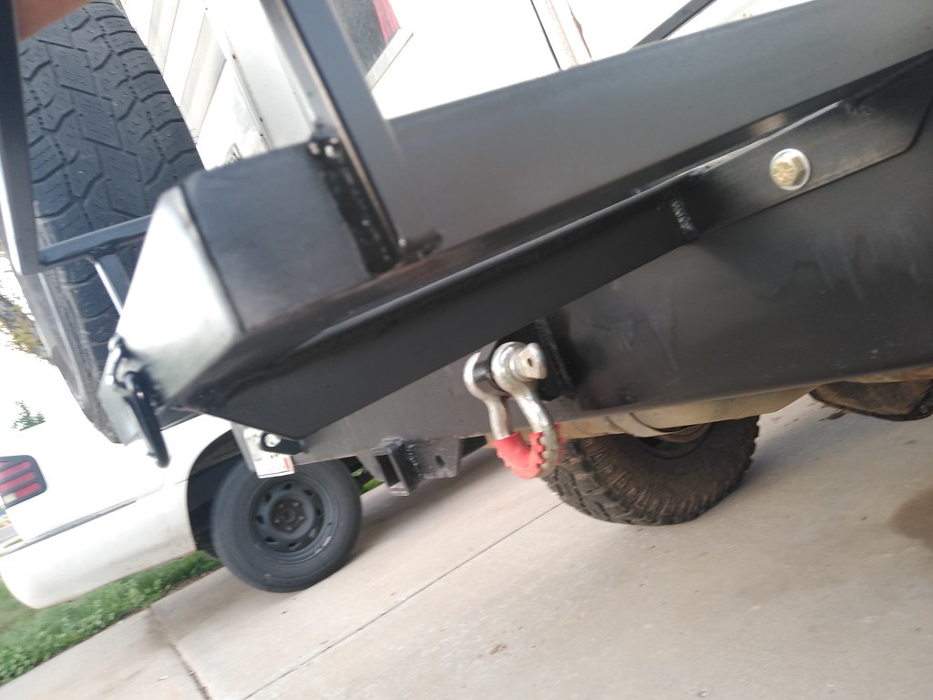

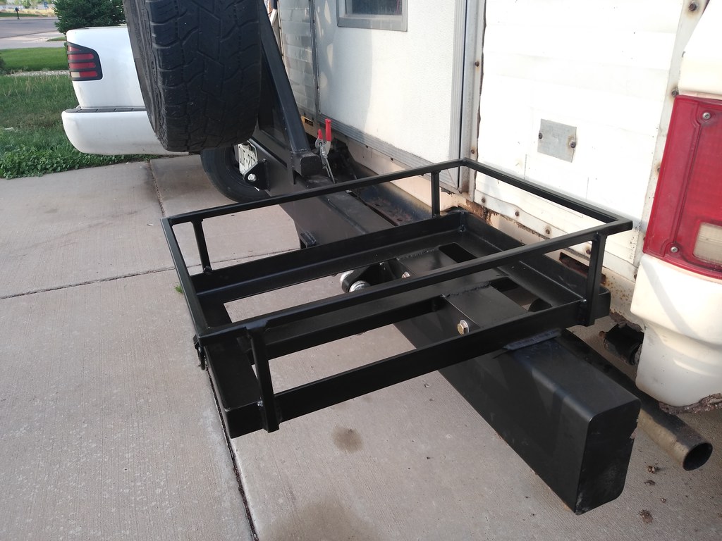

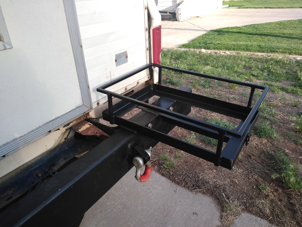

The last major addition is the jerry can rack. Since we were not going to make another swingout for now, we went with a bolt-on approach. The goal was being able to carry 3 cans. Without swinging, one can would be in front of the door if we stacked them in pointing front to back. So we turned the cans 90 degrees to find the space between the door and the taillight was a couple inch wider that the width of the cans. We could stack them in this way and put three in there and have them only hang slightly pass the spare tire.
Bill added a gusset under the center to help with the weight at the edge. The main attachment to the bumper you can see here is a C-channel Bill built to the exact inside dimension to fit snugly over the main bumper. We drilled a couple of holes to match on the bumper and locked it down with some grade 8 hardware.
We added a couple of weld on D-rings to allow the use of a ratchet strap to tie the cans down. Pretty simple and strong.

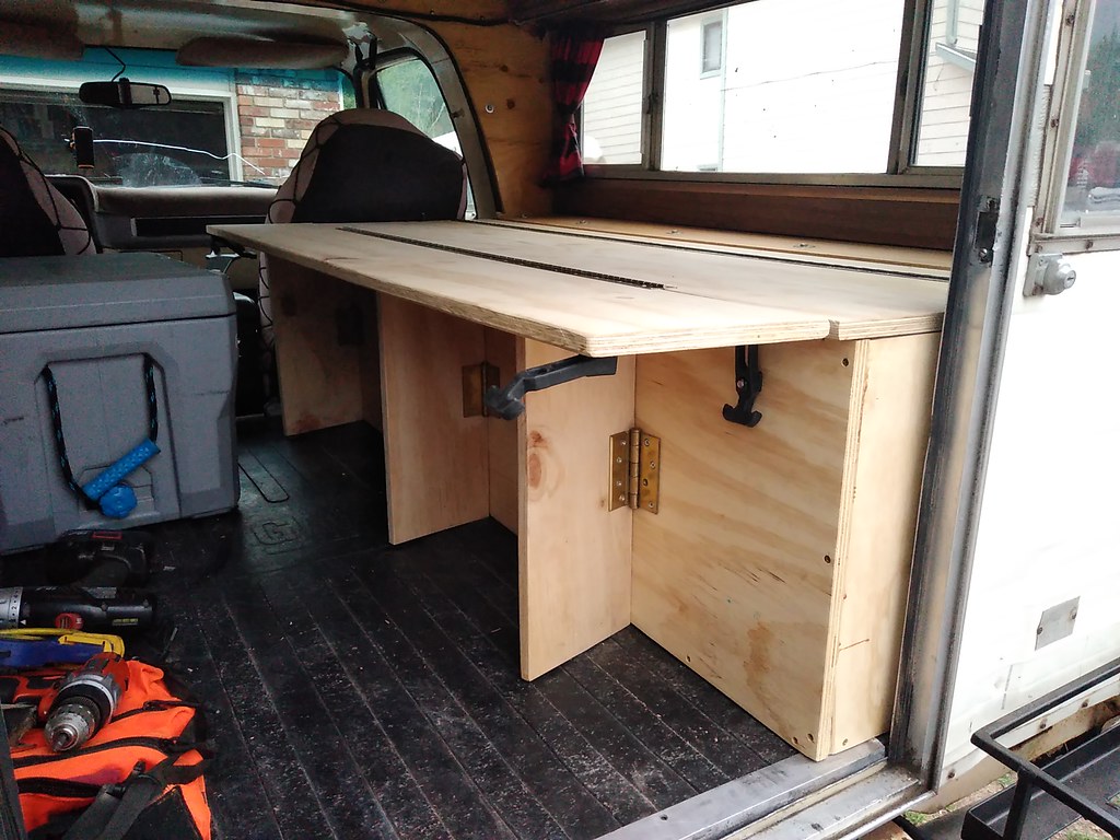

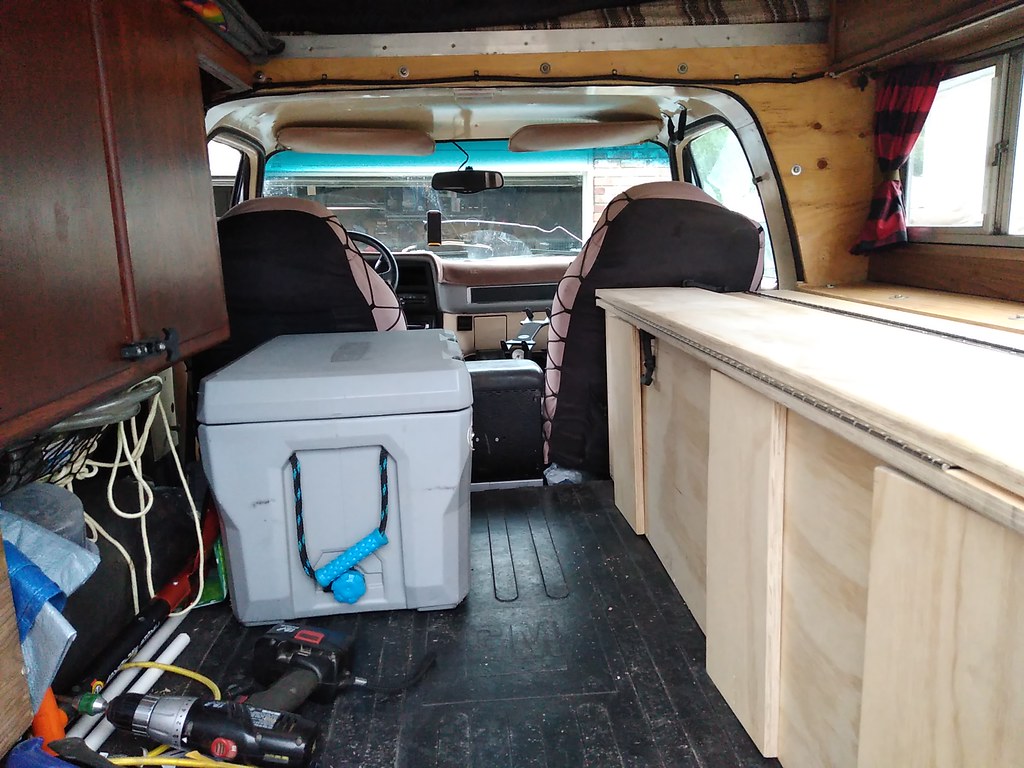

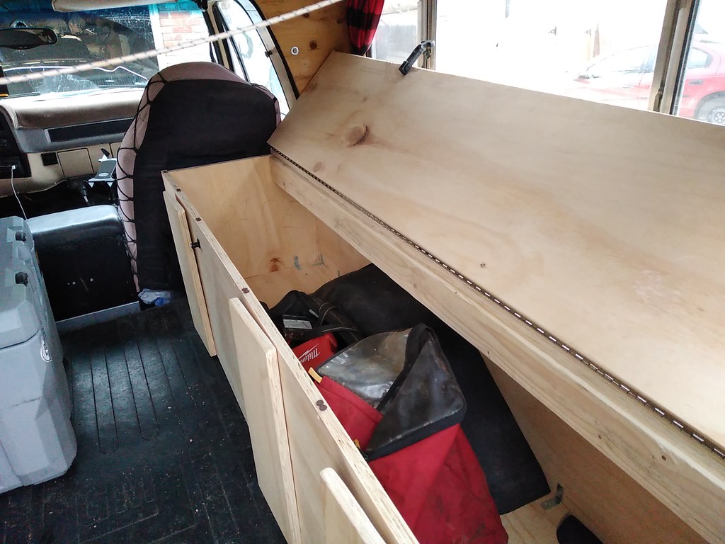

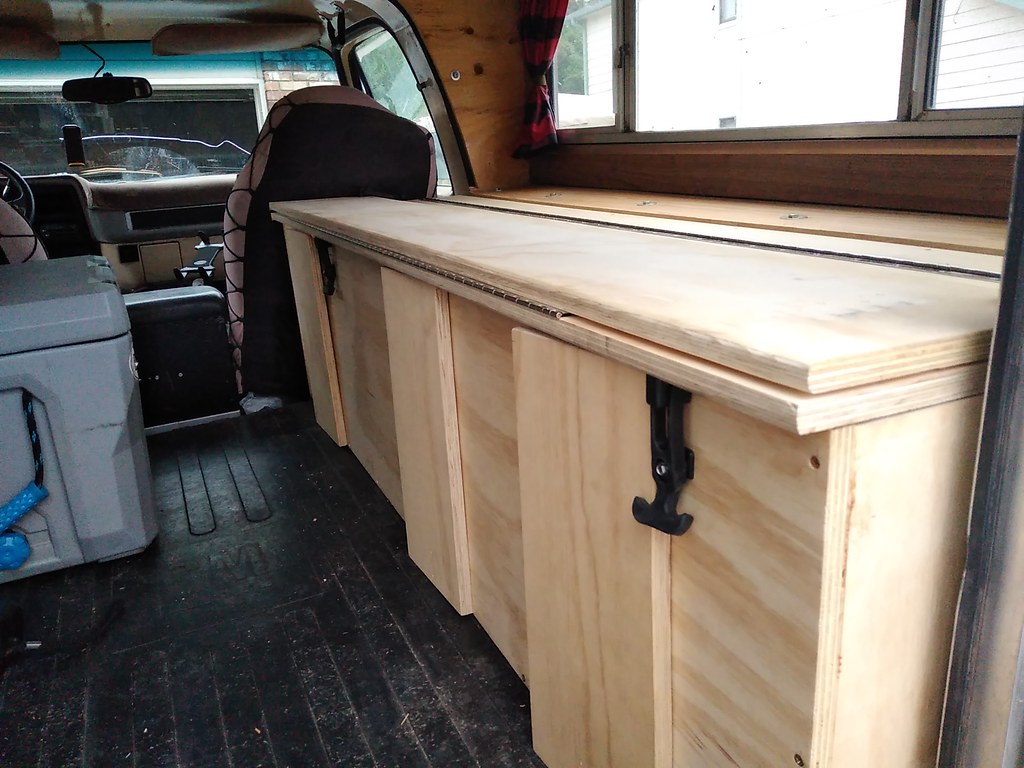

Today I rectified the issues with the new bench. It rattled from all the supports for the added fold out as well as the fold-out section and the main lid too. It had rattled on the street, but the time off pavement really illustrated the need to put a stop to it. Plus not securing the box down allowed it to shift on the floor.
So here's what I did. I added some rubber "T" latches, similar to what's found on some coolers now. TI also wo to the main lid and two to the fold-out section.
I also reconfigured the supports for the fold-out section. Sitting on top like they were added to the noise. I pulled them off and moved them to the side of the bench to fold out. I also added one of the T latches to the main two cabinet doors as they could flop open on rough stuff.
The fold-out section supports still work, but now fold out from the side and tuck in tight under the lid when closed. I've still got room for the cooler with the section out too. So I don't have to pull the cooler to fold it out.
I also added felt pads where the lid closes to so that it adds to quieting the rattle down.
Prep is pretty well done for the trip. I re-organized the camper storage with the new bench. Goal for packing is not having to completely unpack at camp. Things I need to carry but don't need daily access to go in the bench. Tools, spare fluids, camping gear, extra case of water go in that category. Stove got relocated from inside the bench to being stowed on the top of the cabinet. It's locked down with bungee cords and quickly accessible without unpacking or lifting the top up. I was planning on bringing two 55 quart Lifetime (USA built yeti knock-offs) for the food and drinks. One of which would be coming out at camp. However, the plan got changed with one of the other dudes on the trip coming from California selling me his 50L ARB fridge. One Lifetime cooler will still come to carry the food, frozen water and keep some beer cold. I'll load the fridge on Sunday when we meet up with him. Total gamechanger.

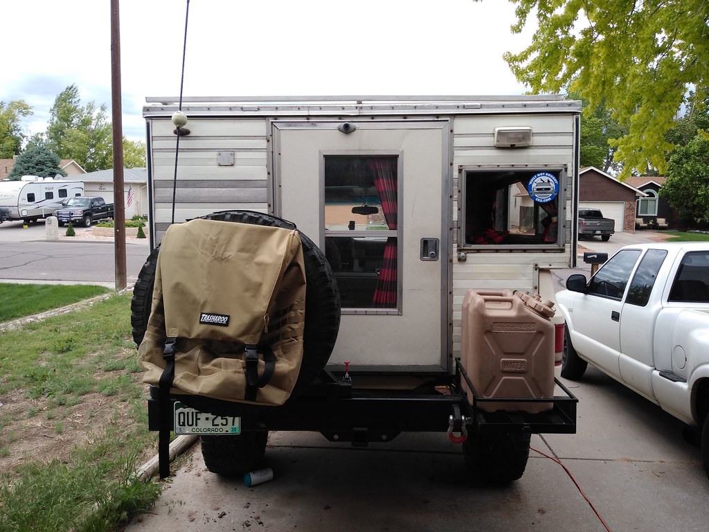

New Trasharoo installed (old one broke a strap and fell off), larger tire installed for the spare and test fitting the water cans in the rack.
So ready to go.
