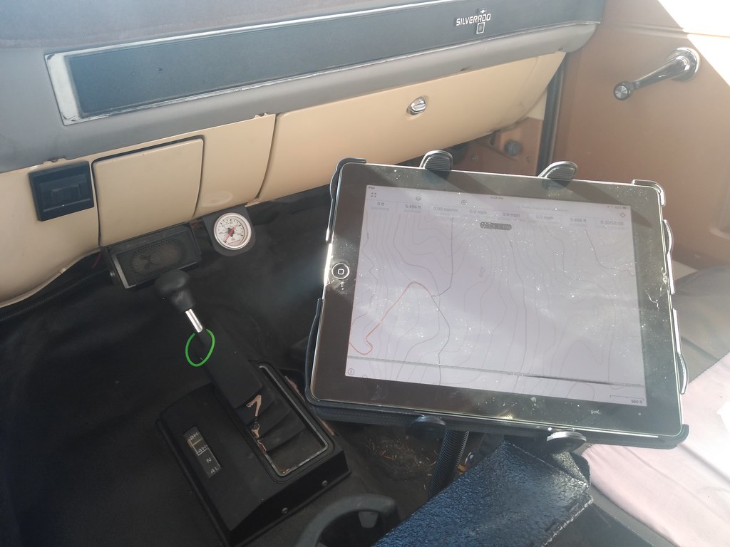

One of which was reconfiguring how my Ipad is situated in the truck. The window mount worked, but did fall off the glass due to the weight when it was hot out. That's slightly problematic while in motion. So I picked up a different mount that attaches with one of the seat mount bolts. It puts it much closer in reach than before and it doesn't block the view out the windshield. It does need an added support strut off of the console to stabilize it. I'll add that tomorrow.
Pretty simple setup though. Pardon the dirt/dust. Been a while since I wiped it out.

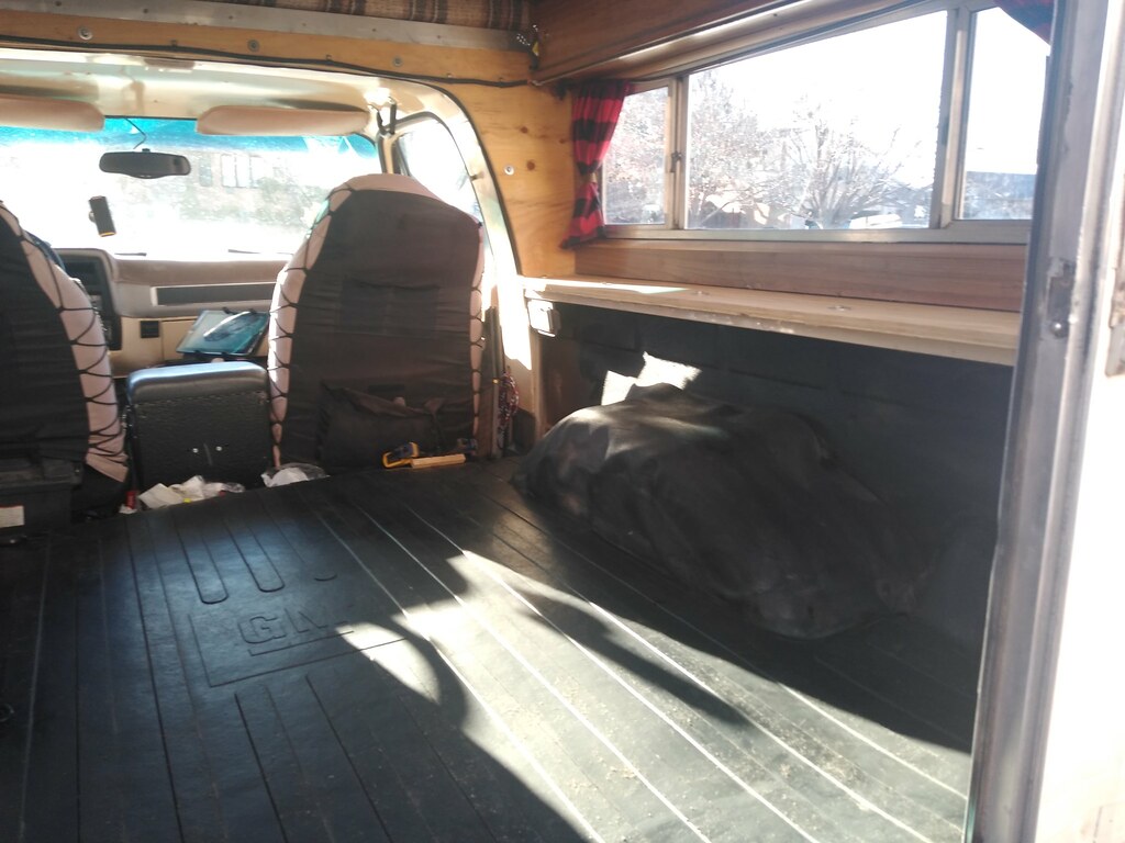

Onward to the lower bench in the camper. It was thrown together pretty quickly last year before the trip. It served it's purpose by reusing the existing lid/cushions, but it sucked to sleep on and actually started pulling away from the side during the trip. I ended up adding some L-brackets to hold it to the side for the rest of the summer. So it's coming out.
With the bench yanked it's all empty again. I went ahead and ran over to the car wash and filled their vacuum full of stuff instead of mine.

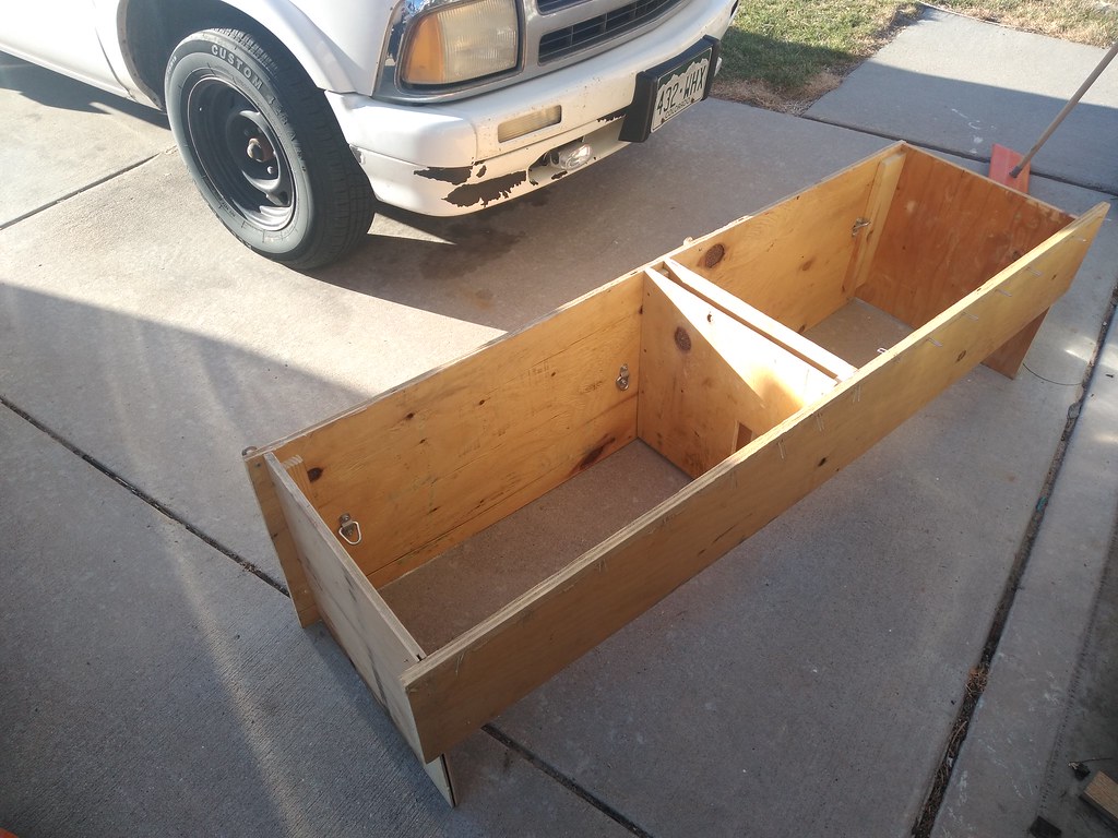

One of my guys at work is a hell of a carpenter and we've talked about what I want. I'll take the truck up to work to let him take measurements and the shape of the wheel tub. The plan is to build a box that fits over the wheel tub and is completely enclosed top to bottom. The top will have two lids hinged at the outside wall to allow access inside. There will be a divider wall in the center in line with the two lids. From there the back section will have some dado's cut in the sides and bottom to add more dividers to fit gear into specific spots like the campstove, griddle and other items. Unlike the original cushions being part of the lid I'm going to make them separate. I've got 4" memory foam and will make some covers for them. To widen the sleeping surface we are going to add a section to each lid that is hinged on the inside edge that will allow it to flip open and add another 6" of width to the surface that an extra cushion will lay on top of. There will be a couple of legs that add support when the extra section is opened up.

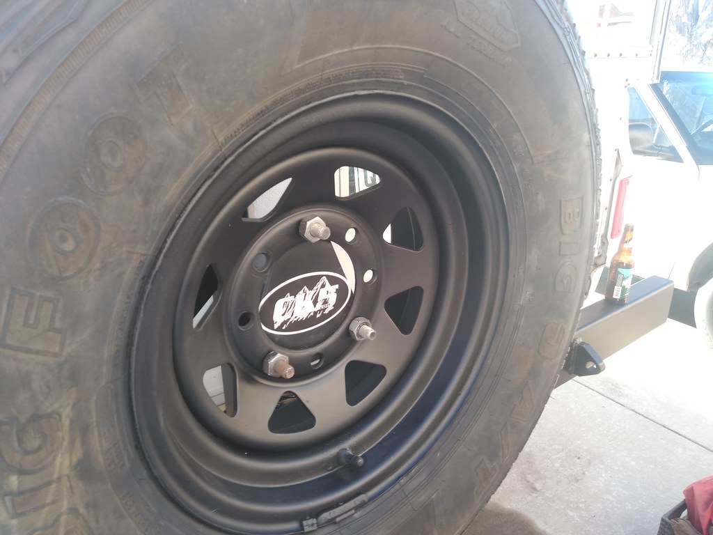

Since it was in the 50's today I went ahead and took care of something that was bugging me since we bolted the bumper on. The crusty white spare. I hit it with a wire cup brush to knock the loose stuff off and wiped it clean and fogged it flat black. It just looks a lot cleaner that way. Plus I could put the obligatory CK5 sticker in the center of the carrier.

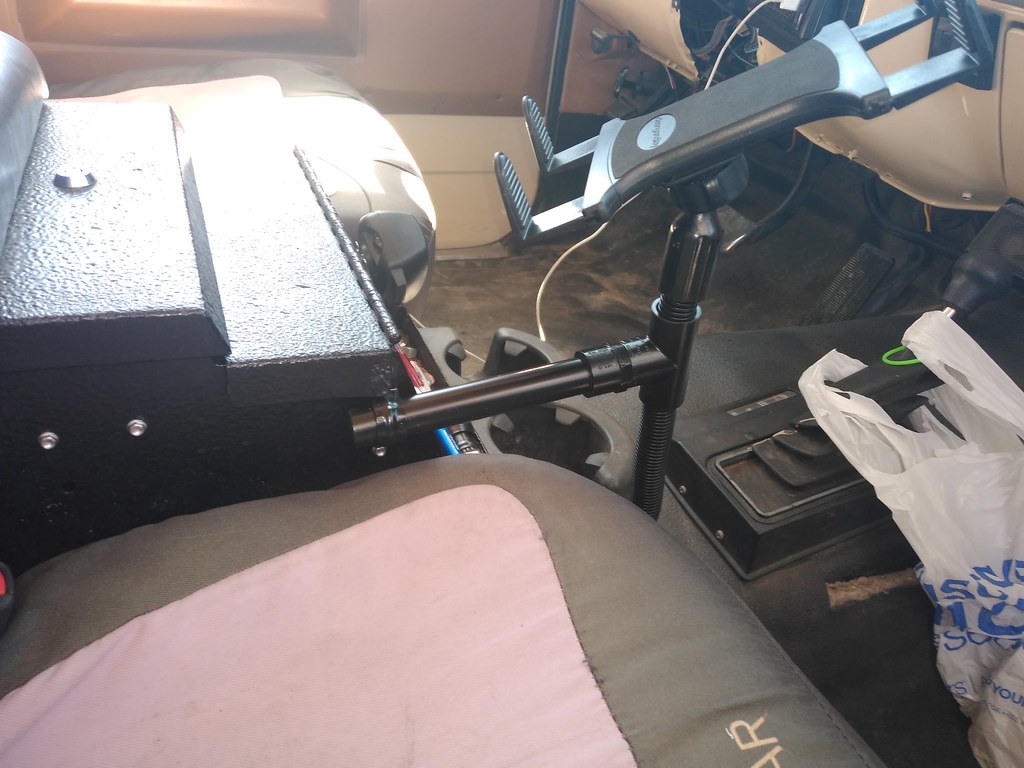

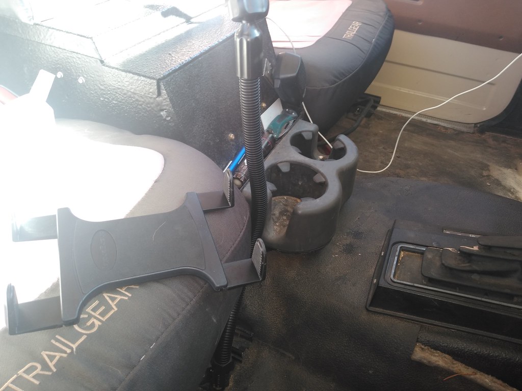

Groundbreaking fabrication day. Added the needed support strut to the iPad mount. Some 1/2" pvc pipe and fittings and a clamp the mount is much more solid.
Compared to other's fabrication talents, this is more like arts-n-crafts day. The actual mount uses a solid aluminum shaft that is bendable. The diameter of the shaft is closer to 3/8" under the flexible conduit. So the smallest size pipe I could use was 1/2". I used a T fitting with a screw in adapter to the pipe. Cut the pipe to length and attached it to the console with the clamp. Once I had it where I wanted it I blew it apart and fogged the parts with fusion plastic paint to make it match.

That's going to be so much nicer to get your pad out of the direct sunlight and heat this year :thumb:
Anxious to see the new lower bench installed!
That was a driving reason for the change. I never saw an iPad overheat (it actually said that on screen) and shut off before.
Plus I'll have a better view out of the picture window.
I'm excited for the bench too. I brought up to have my guy take some measurements off of the truck today. Need to get some weight over to that side too. With it empty it's listing to the left now even before I sit my fat arse in it.
