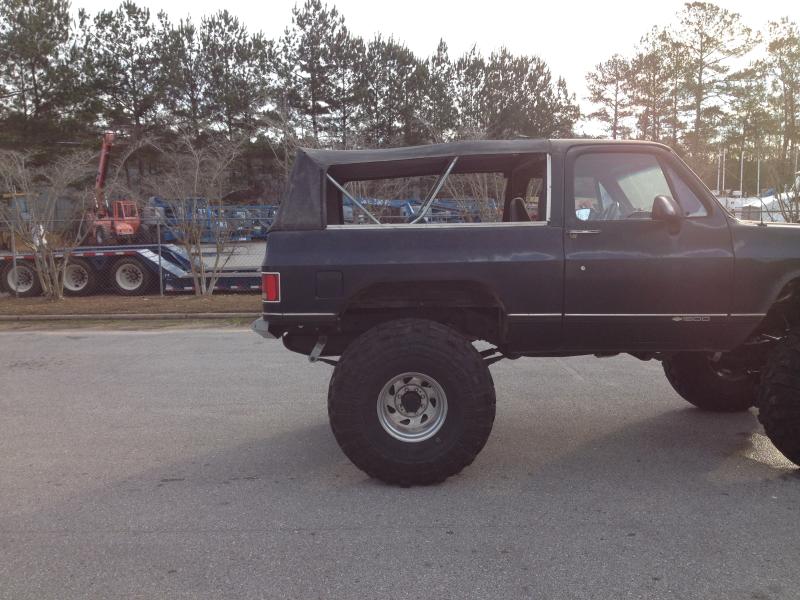

This build was 2 parts 1 i have a truck I made to pretty to wheel so I'm building an ugly one I can actually enjoy. And 2. My cousin has been trying to join us for blazer bash but his truck wont be ready so we are surprising him with this one

I'm running the ORD 2.5" shackle flip on my blazer, I need new springs and I was going to get ord custom springs. I was thinking of swapping brackets sides to gain the extra 2" of length so I'd be running a 54" spring vs 52". Think I would gain anything from the extra 2" ? Would it be worth the work? Because of my rear bumper setup I can't push the brackets back any further to get 56" springs.
Flipping my 4” lift brackets allow for 56s. Maybe same for you? If you let the MAW bug get you, swap the brackets, order the springs with an offset pin to push the axle back further. I didn’t even notice any downside when I flipped my 56s around. (Flipping moves axle back 4”) Moving the axle back only helps :) problem becomes DS length and shock location.
Being that you wheel the crap out of that thing, if going with new ord springs I would switch from the shackle flip to their new stock style boomerang shackle setup. Give you way more droop.
Like K85 Octane mentioned, usually flipping the brackets is done to step up to 56" springs. I did that in my old K5. Everyone I know that did it was happy with the swap. You will likely need a 6" shackle if you don't already have one.
Yeah I spoke with ORD and they told me flipping the 2.5" brackets will only push it back 2" and if I want to keep my shackle angle correct I should only do a 54" spring. I don't want to totally redo my rear setup but the new style shackle does spark some interest. I currently have my axle back 1.5" from stock and I may push it to 2 or 2.5" back.
