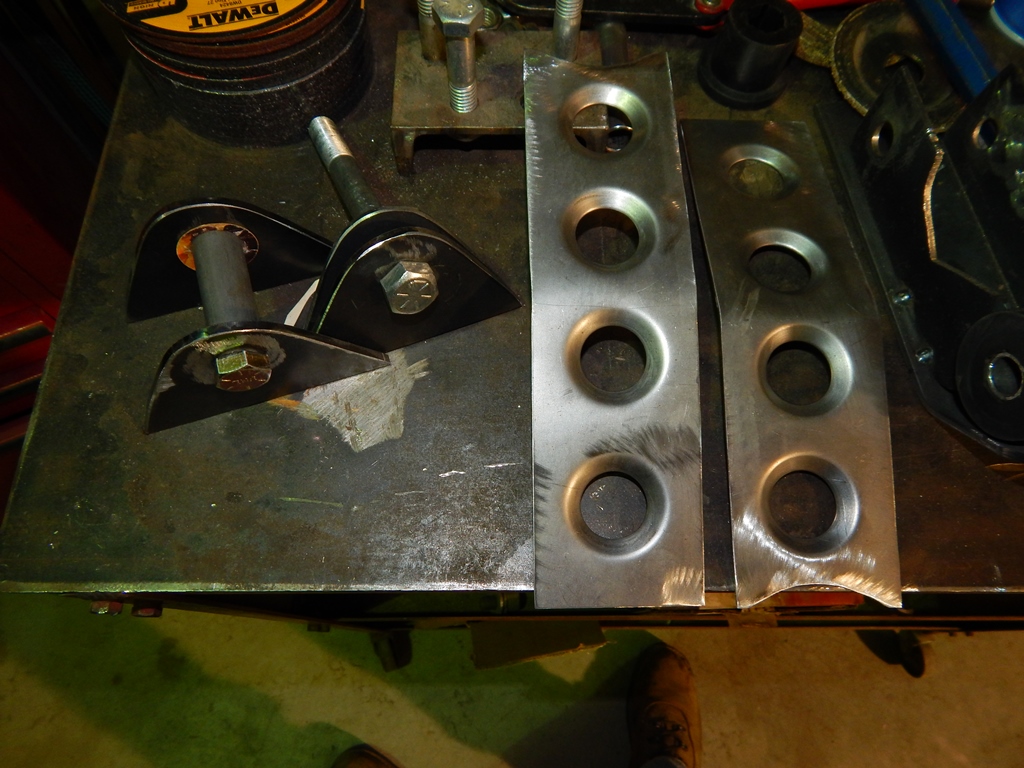

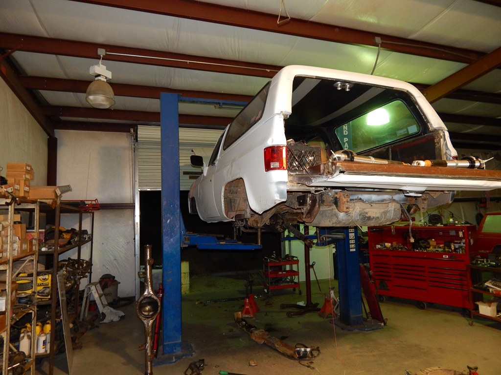

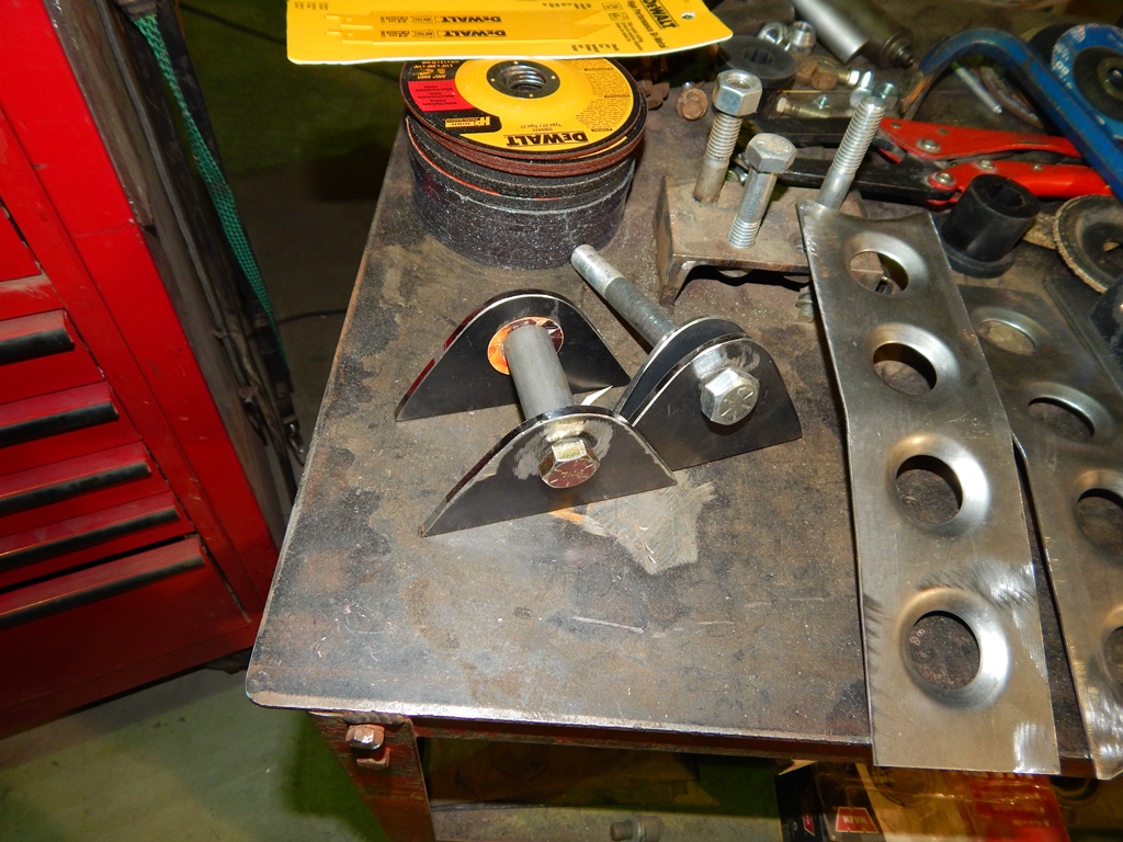

In the mean time, I have made the radius arm tabs, beam pivot dimples(which you've seen) I cleaned some stuff up, organized my work area(yay) and squared the chassis up along with squaring it up on the lift. More to come.

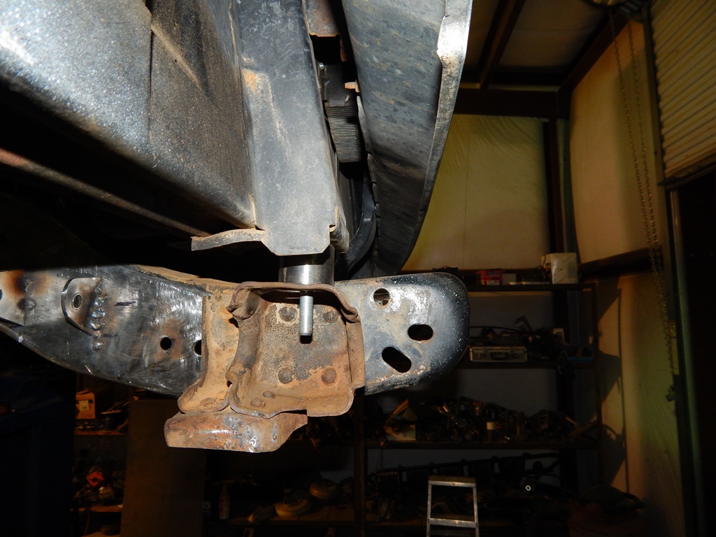

I got the Frame brackets welded up.

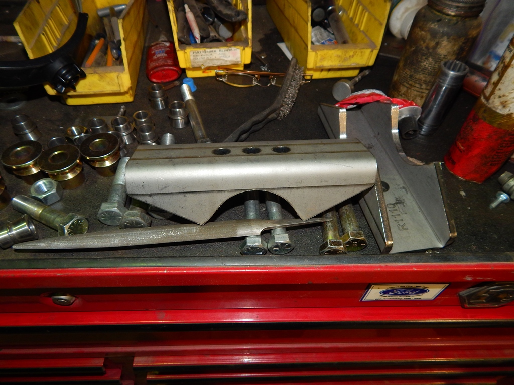

Body mounts also made, what a pain!! but they are done! I increased the spacing 1/2 inch so technically is a mini body lift.
Ditched the front spring hangars finally! This was ceremonial haha finally divorced

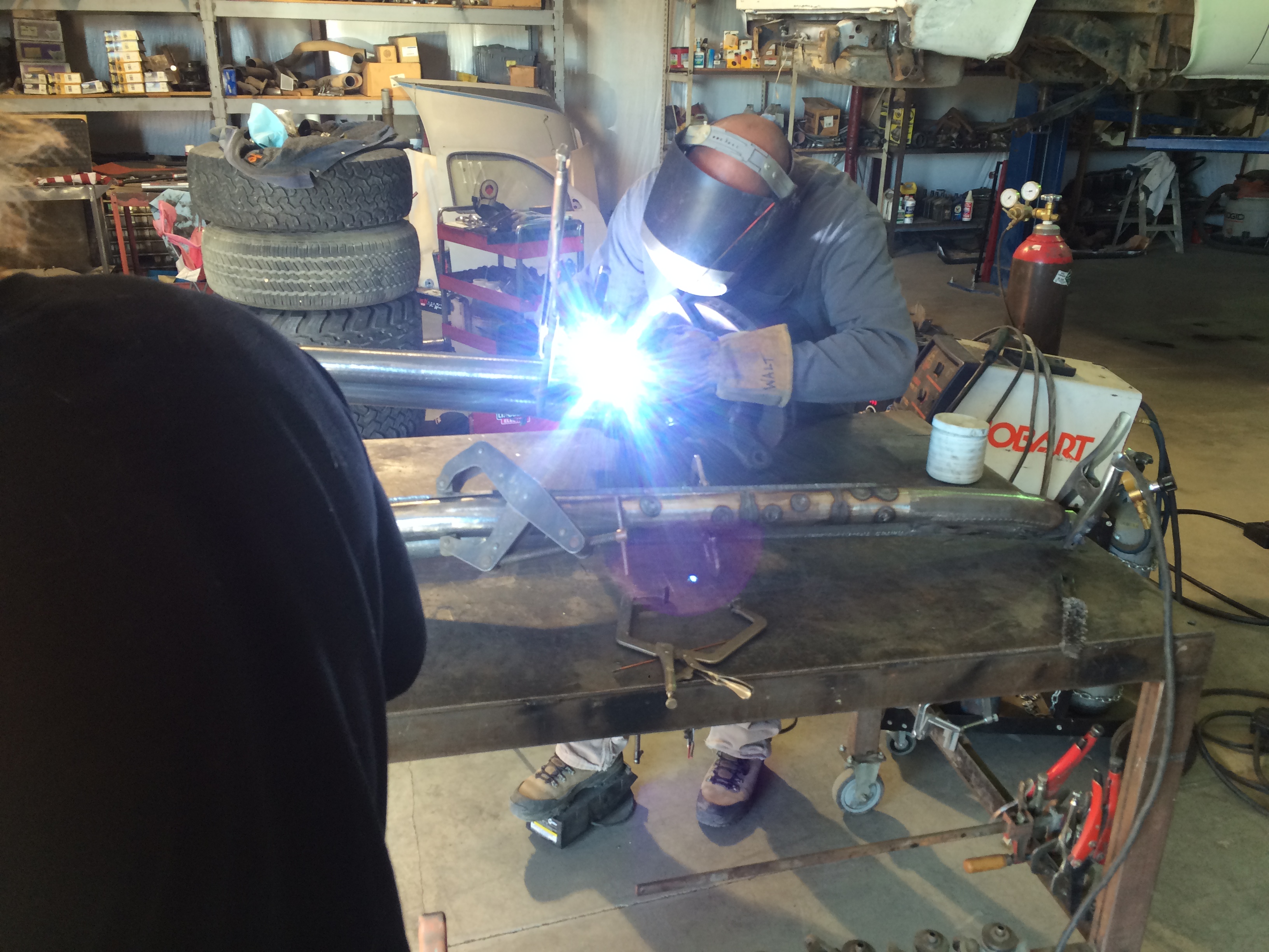

And there is lots more to come! I have yet to take pics of the finished beams!!! I actually got flash burned really bad and couldn't see for a day!! scary stuff. Remember people always wear your PPE but even when you do be thoughtful of your surroundings because radiation can get you even if your not facing it!
